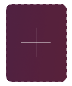

On a drum. Hover a drum that your hardware feeds but that has no instrument yet, and a + appears on its head (on a cymbal, on the bell). Click it for a menu titled with the input it fills, such as Add to Snare 1:
  • the instruments for that kind of drum (for a snare input, Snare instruments), one submenu per library: your own first, then the Core Library and each sound pack
  • Other instruments: everything else, one submenu per role
  • Controllers and Generators: blank objects from the Build library
Whatever you choose arrives already wired to that drum, as if you'd dragged it from the library onto the drum. The + never appears on a drum that already has an instrument, so it doesn't get in the way while you play. To stack a second instrument on a drum, right-click it for the same menu.
On the whole kit. The area behind the drums is the kit itself. Hover it and a + appears at its top right. When no drum in the set has an instrument yet, the + stays visible. It lists the drum kits in the library, grouped by library the same way. Choosing one maps its instruments across all the drums your hardware is sending, the same as dragging a kit onto the graphic. Right-click the kit area to stack a second kit.
From the Input routing list. The dashed + in an input's Set column opens the same menu for that input. This is how you fill inputs that aren't drums: MIDI and pad inputs offer instruments, controllers, and generators, and an analog input, which carries audio rather than hits, offers the Audio Insert that reads it.
