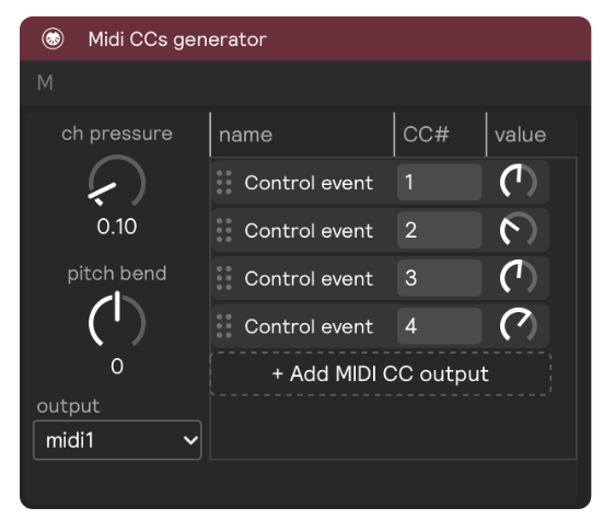

You can organize MIDI output of Sensory Percussion using the MIDI notes generator, MIDI CCs generator, and MIDI router.

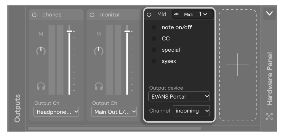

To use the different MIDI generators, you must have MIDI outputs added to your Hardware Outputs, one for each MIDI channel you want to send out of Sensory Percussion V2.
Then drag either the MIDI notes generator or the MIDI CCs generator into your set and then select the corresponding output from the dropdown.
