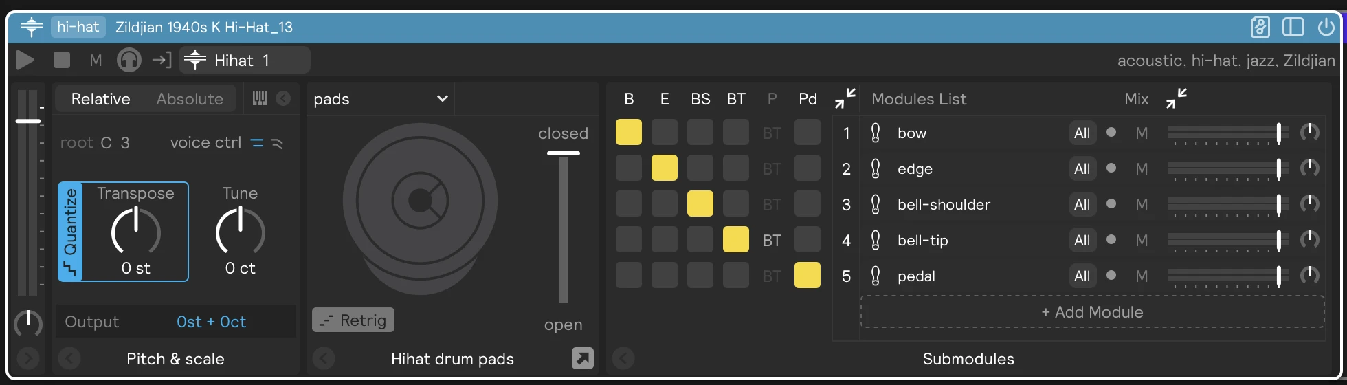

Like Cymbal Pads, Hi-hat Pads distributes modules across the zones of a hi-hat. Drag samples, samplers, controllers, effects, and more onto the zones, as on the other drum pads. Unlike the other pads modules, Hi-hat Pads also tracks your hi-hat pedal.
A Hi-hat Pads controller with five submodules mapped to bow, edge, bell-shoulder, bell-tip, and pedal, and the pedal slider between closed and open
The zones and their abbreviations in the matrix are:
  • bow (B)
  • edge (E)
  • bell-shoulder (BS)
  • bell-tip (BT)
  • ping (P)
  • pedal (Pd)
Pedal​
The vertical pedal slider, between closed and open, shows the hi-hat pedal position. It follows your physical pedal as you play, and it defaults to closed.
It's also a real parameter. Drag it to set the pedal position by hand, for example when no pedal is connected, or right-click it to assign a modulator or macro to it.
The pedal position drives any Hi-hat Pedal Controller inside, which blends its layers from open to closed.
